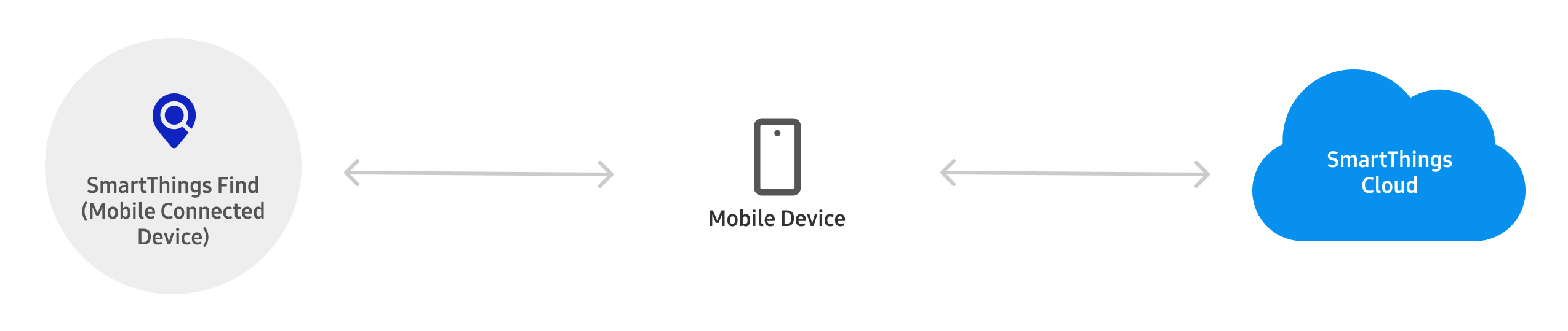

SmartThings Find Devices​
A SmartThings Find Device is a BLE (Bluetooth Low Energy) device compatible with the SmartThings Find service.
SmartThings Find uses BLE and UWB (ultra-wideband) technologies to help you quickly locate your connected devices. By using AR in conjunction with maps and sounds, SmartThings Find offers a simple and visual solution to help guide you to your missing device.
With SmartThings Find, you can locate your missing device, even if it is offline. SmartThings users can opt in to securely use their Galaxy smartphone or tablet to help others locate their lost devices. Once a device has been offline for 30 minutes, it produces a BLE signal that can be received by other devices. If you report your device as lost via SmartThings Find, any nearby Galaxy smartphone or tablet that has opted into helping find misplaced devices can alert the Samsung server about its location, which will in turn notify you.
All SmartThings Find user data is encrypted and securely protected, ensuring that the device’s location is not revealed to anyone except its owner.

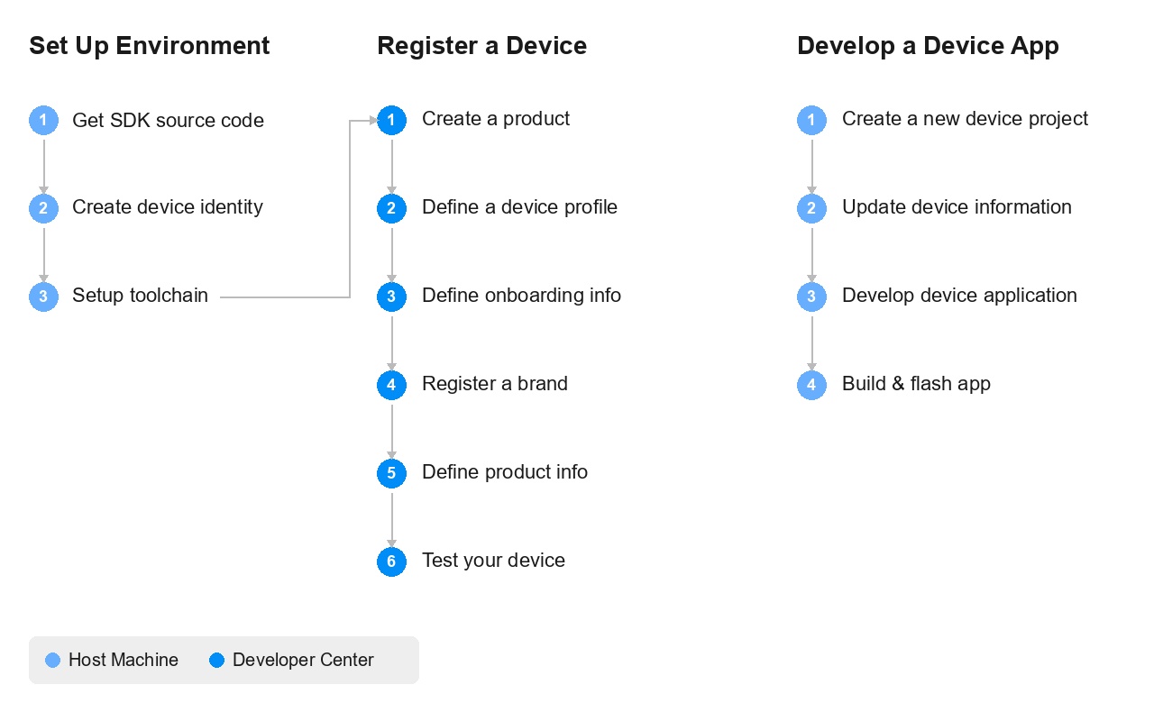

Workflow​
When developing a new Mobile Connected Device application with the SDK, you'll progress through the following phases:
  1. Setup Environment
  2. Register a Device
  3. Develop a Device App
  4. Publish and Commercialize
You can see an in-depth overview of the development workflow below:
workflow
